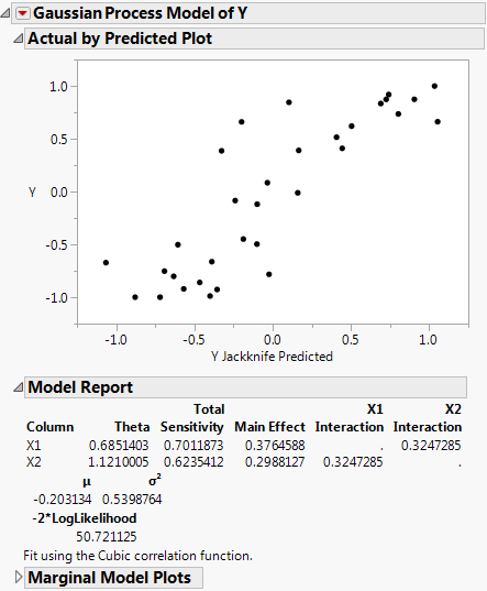

This example uses data from a space filling design in two variables with a deterministic equation for Y (the response). You can use the Gaussian Process platform to find the explanatory power of X1 and X2 on Y. You can view the equation for Y in the column formula.
Select Analyze > Specialized Modeling > Gaussian Process.
5.
Select Correlation Type > Cubic.
6.
Deselect Fast GASP. |
7.
Click OK.
8.
Click the red triangle next to Gaussian Process Model of Y and select Save Prediction Formula.
9.

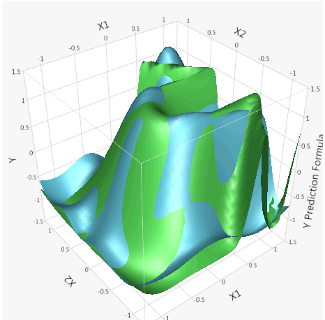

Select Graph > Surface Plot.
10.
11.
Click OK.
12.
In the Surface column, select Both sides for the Y Prediction Formula.
Deselect
