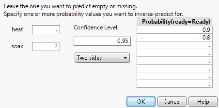

From the red triangle next to Nominal Logistic Fit for ready, select Inverse Prediction.
Delete the value for heat.
Enter 2 for soak.
You want to predict heating time when soak is 2.
6.
Click OK.

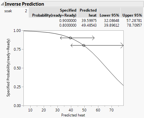

When soak is 2, the predicted value of heat for which there is a 90% chance of an ingot being ready to roll is 39.60 with a 95% confidence interval from 32.09 to 57.29. When soak is 2, the predicted value for heat for which there is an 80% chance of an ingot being ready to roll is 49.49 with a 95% confidence interval from 39.90 to 78.71.
