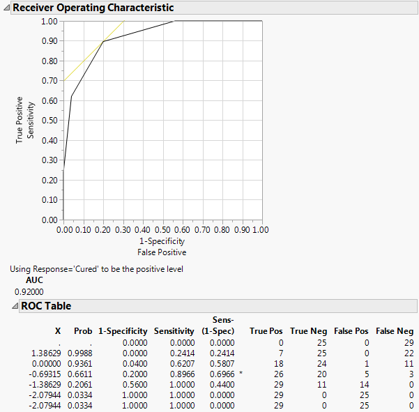

From the red triangle menu, select ROC Curve.
7.
Select Cured as the positive.
8.
Click OK.
Note: This example shows a ROC Curve for a nominal response. For details about ordinal ROC curves, see ROC Curve in the Predictive and Specialized Modeling book.
The results for the response by In(Dose) example are shown here. The ROC curve plots the probabilities described above, for predicting response. Note that in the ROC Table, the row with the highest Sens-(1-Spec) is marked with an asterisk.
