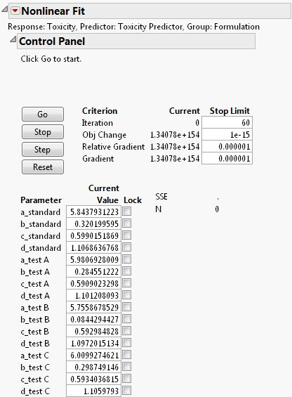

6.
Click OK.
The Nonlinear Fit window appears (Nonlinear Fit Control Panel). In the Control Panel, parameter values and locking options are shown. The letters listed before each parameter correspond to variables from the Prediction Model in the Fit Curve function.
7.
8.

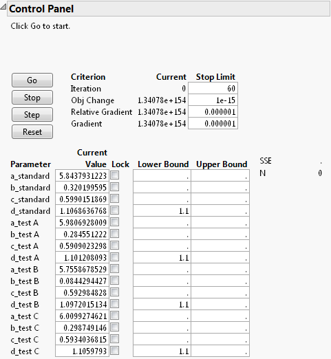

Set the lower bounds for the parameters as shown in Setting Parameter Bounds. You know from prior experience that the maximum toxicity of the drug is at least 1.1.
9.
Click Go.

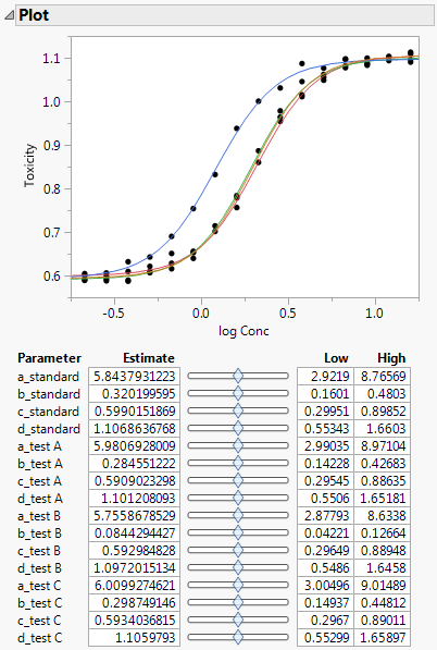

The final parameter estimates are shown in the Solution report, along with other fit statistics (Nonlinear Fit Plot and Parameter Estimates). The fitted model is shown on the plot.
