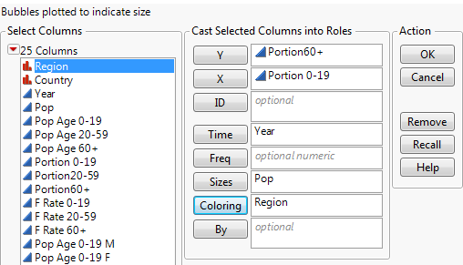

This example uses the PopAgeGroup.jmp sample data table, which contains population data for countries and regions around the world. Examine the relationship between the proportion of younger and older people in the sample populations.
Select Graph > Bubble Plot.
5.
6.
7.
8.
Bubbles for different regions are assigned different colors. See the Region legend in The Bubble Plot Report Window. The colors shown in the plot are JMP default colors.
9.
Click OK.
11.
(Optional) To view a legend that identifies each color with its region, select Legend from the red triangle menu.
