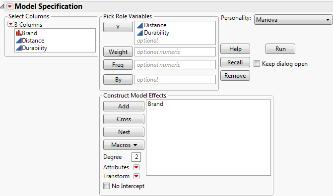

Select Analyze > Fit Model.
5.
6.

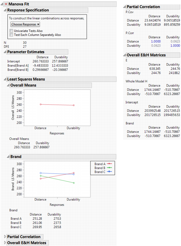

Click Run.
The initial results might not be very interesting in themselves, because no response design has been specified yet. After you specify a response design, the multivariate platform displays tables of multivariate estimates and tests. For details about specifying a response design, see Response Specification.
