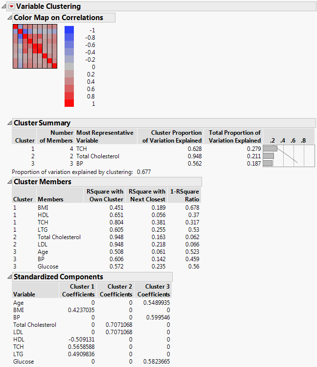

Cluster Variables Report for Diabetes Data
The Variable Clustering report is shown in Cluster Variables Report for Diabetes Data. The Cluster Summary report shows that the variables were grouped into three clusters:
Cluster 1 consists of BMI, HDL, TCH, and LTG, as shown in the Cluster Members report. The Cluster Summary report shows that TCH is the most representative variable for Cluster 1 and that it explains 62.8% of the Cluster 1 variation.
Cluster 2 consists of Total Cholesterol and LDL. The Cluster summary report shows that Total Cholesterol is the most representative variable for Cluster 2 and that it explains 94.8% of the Cluster 2 variation.
Cluster 3 consists of Age, BP, and Glucose.The Cluster Summary report shows that the most representative variable is BP and it explains 56.2% of the Cluster 3 variation.
