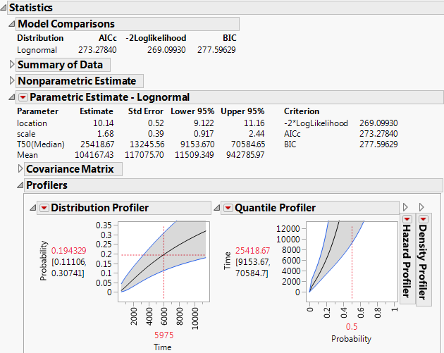

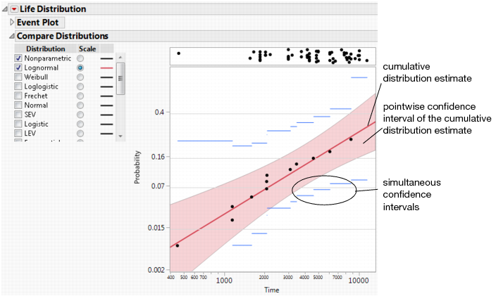

In the Compare Distribution report, select Lognormal distribution and the corresponding Scale radio button.
Below the Compare Distributions report, the Statistics report appears (Statistics Report). This report provides a Model Comparison report, nonparametric and parametric estimates, profilers, and more.
