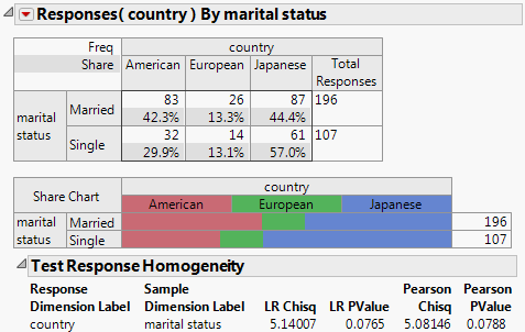

This example uses the Car Poll.jmp sample data table, which contains data collected from car polls. The data include demographics about the individuals polled and information about the cars that they own. You want to explore the relationship between marital status and origin of car. You also want to test for the homogeneity of the responses. That is, you want to test to see whether the distribution of the origin of cars is the same for married and single respondents.
5.
Click OK.
6.
Click the Categorical red triangle and select Test Response Homogeneity.
