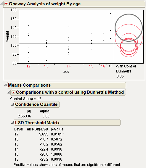

From the red triangle menu, select Compare Means > With Control, Dunnett’s.
Alternatively, click on a row to highlight it in the scatterplot before selecting the Compare Means > With Control, Dunnett’s option. The test uses the selected row as the control group.
8.
Click OK.
Using the comparison circles in Example of With Control, Dunnett’s Comparison Circles, you can conclude that level 17 is the only level that is significantly different from the control level of 12.
