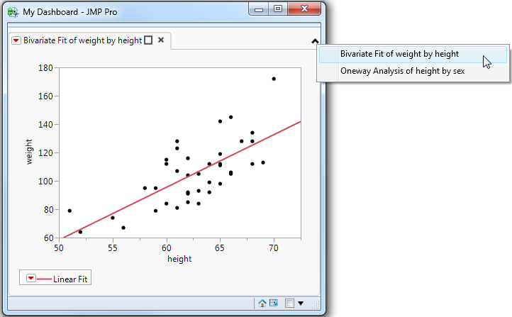

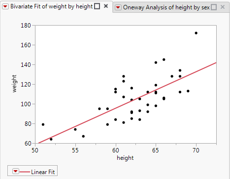

In a dashboard with several tabs, the window widens to show all tabbed reports. You might want to show only the first report and then let the user select the other tabbed reports from a list. Change Set Overflow Enabled( 0 ) near the end of the script to Set Overflow Enabled( 1 ). Dashboard with Overflow Tabs shows the result.

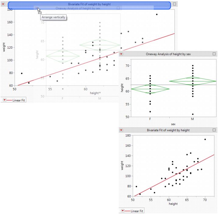

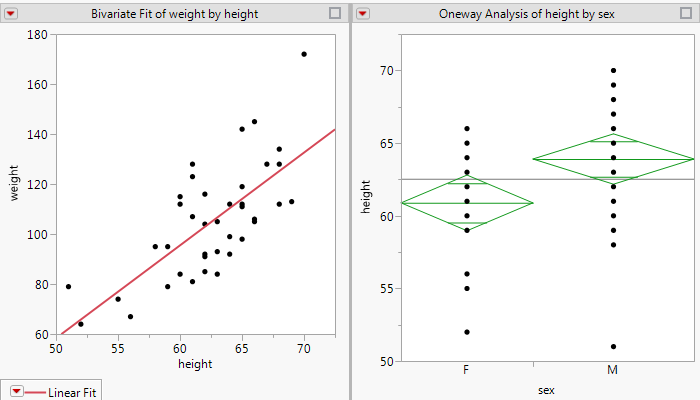

A docking layout is a collection of Tab Page Box() objects and docking containers that enable reports to be rearranged. In the report window, you drag a docked tab to a highlighted drop zone to create a new layout. Dashboard with Two Reports shows two docked reports. In Docking a Tab in a Dashboard, the Distribution report was dragged to the highlighted drop zone to display the reports in one column.
