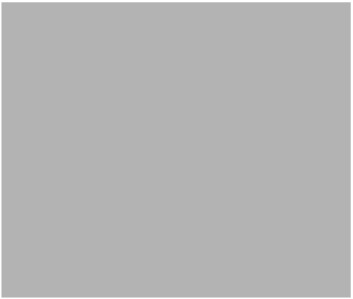

Click Run again.
The script runs until it hits the breakpoint. The results are shown in Global Variables at First Breakpoint.
stringFunction() is called, evaluated, and returns to the loop.
i is incremented and determined to be less than or equal to 9.
5.

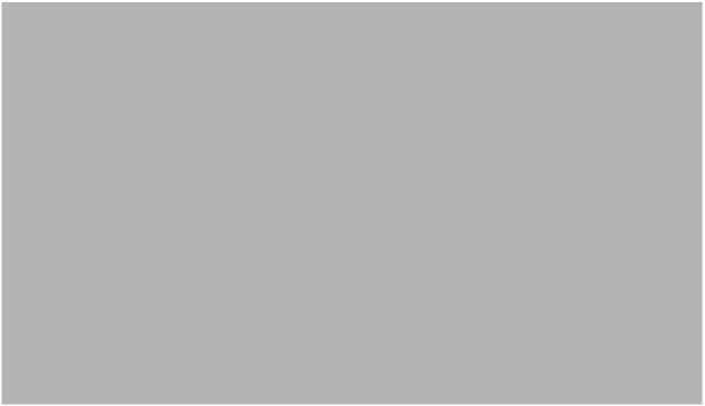

Click Run again.
The script runs until it hits a breakpoint. The results are shown in Global Variables at Second Breakpoint.
You can continue to click Run and watch i and str change with each iteration of the loop. Or, click Run without breakpoints to complete running the script and exit the Debugger.

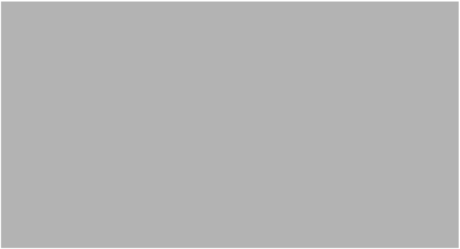

Click Step Over.
The fourth line turns off Names Default To Here. If you run this script again in the same JMP session, this line resets the scoping so that the first variable that is created is in the global scope.
Click Step Over.
A global variable named x is created. On the Globals tab, x has been added to the list, showing its value as 5 and its type as number.
The global variable x is also shown here.
5.
