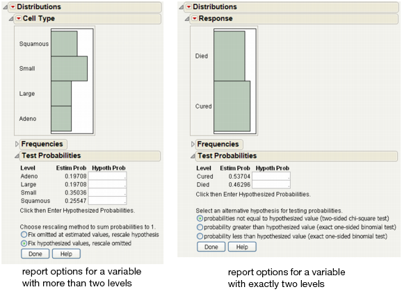

Select Analyze > Distribution.
Click OK.
5.
From the red triangle menu next to Cell Type, select Test Probabilities.
See Figure 3.13 at left.
Click OK.
5.
From the red triangle menu next to Response, select Test Probabilities.
See Examples of Test Probabilities Options at right.
Refer to Figure 3.13 at left. Type 0.25 in all four Hypoth Prob fields.
Click the Fix hypothesized values, rescale omitted button.
Click Done.

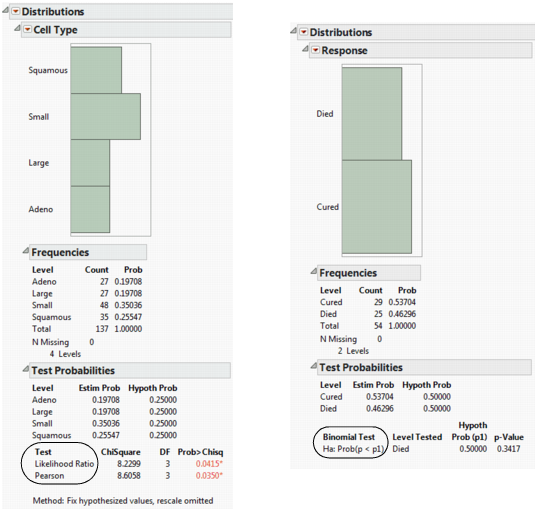

Likelihood Ratio and Pearson Chi-square tests are calculated. See Examples of Test Probabilities Reports at left.
Refer to Figure 3.13 at right. Type 0.5 in both Hypoth Prob fields.
Click the probability less than hypothesized value button.
Click Done.
