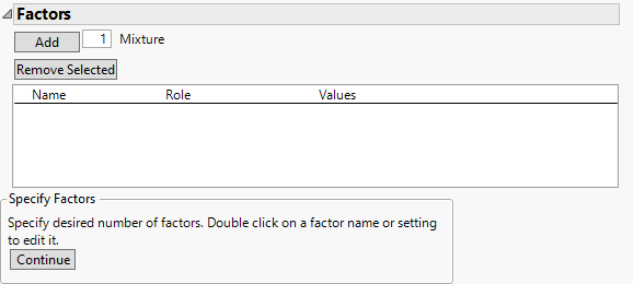

Tip: When you have completed the Factors outline, consider selecting Save Factors from the red triangle menu. This saves the factor names, roles, changes, and values in a data table that you can later reload.
The name of the factor. When added, a factor is given a default name of X1, X2, and so on. To change this name, double-click it and enter the desired name.
To edit a value, click the value in the Values column.
Click the Linear Constraint button to enter one or more linear inequality constraints. A template appears for a linear expression involving all the continuous factors in your design. Enter coefficient values for the factors and select the direction of the inequality to reflect your linear constraint. Specify the constraining value in the box to the right of the inequality. To add more constraints, click Linear Constraint again.
Note: When you save a script for a design that involves a linear constraint, the script expresses the linear constraint as a less than or equal to inequality (
