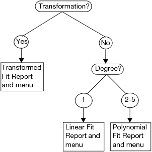

Depending on your selections in the Fit Special window, you see different reports and menus. The flowchart in Example of Fit Special Flowchart shows you what reports and menus you see depending on your choices.
The Transformed Fit report contains the reports described in Linear Fit and Polynomial Fit Reports. However, if you transformed Y, the Fit Measured on Original Scale report appears. This shows the measures of fit based on the original Y variables, and the fitted model transformed back to the original scale.
