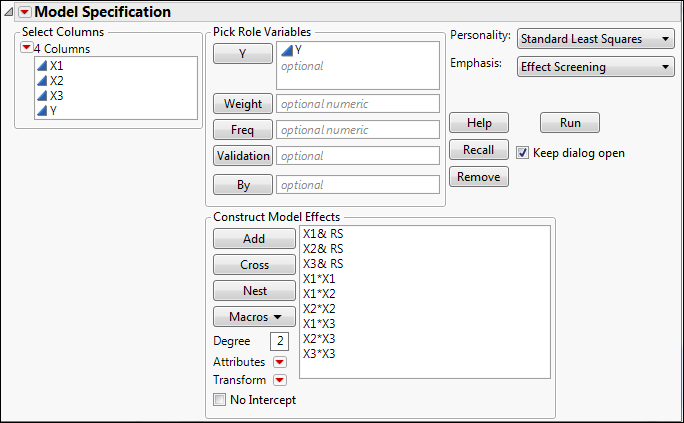

Select Help > Sample Data Library and open Design Experiment/Custom RSM.jmp.
Select Analyze > Fit Model.
Because the data table contains a Model script, the Model Specification window is filled out as specified in the Model script. Note the following:
Main effects appear in the Construct Model Effects list with a &RS suffix, indicating that the Response Surface macro has been applied.
Because the model contains terms with the &RS suffix, the analysis results will include a Response Surface report.
Fit Model Launch Window for the Response Surface Analysis
Click Run.
