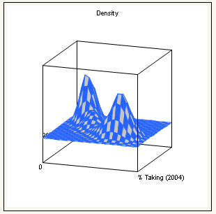

Displays a slider for each variable, where you can change the standard deviation that defines the range of X and Y values for determining the density of contour lines.
