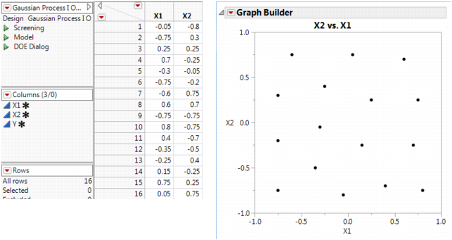

Gaussian process IMSE optimal designs are alternatives to the Latin Hypercube design. You can compare the IMSE optimal design to the Latin Hypercube (shown previously in Two-factor Latin Hypercube Design). The table and overlay plot in Comparison of Two-factor Latin Hypercube and Gaussian IMSE Optimal Designs show a Gaussian IMSE optimal design. You can see that the design provides uniform coverage of the factor region.
