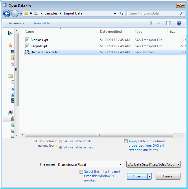

When you open a data set in JMP, the file opens as a data table. JMP uses SAS variable names as column names by default. To use variable labels in a specific file on Windows, select the option when you open the file (see step 5 below).
Select File > Open.
Note: SAS variable names and formats are preserved and can be saved after changes are made to the SAS data set. See Save as a SAS Data Set in Save and Share Data.
Sets the default file type choice to the option that you select next to the File name list If selected, the default file type will be SAS Data Sets the next time you reach this window.
Lets you enter the name of a specific member, or table, for JMP to open. On Macintosh, select Member Tables > Specified and then enter the name.
Opens all members, or tables, in the transport file. On Macintosh, select Member Tables > All.
Tells JMP to open only certain columns from the transport file. Select the columns that you want to import from the list that appears. On Macintosh, the option is Select columns before opening.
7.
Click Open.
