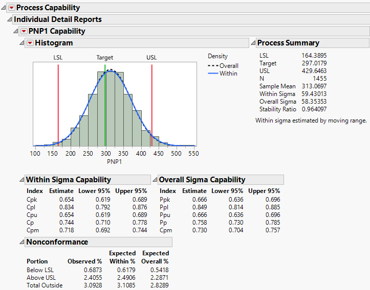

Individual Detail Report shows the Individual Detail Report for PNP1 from the Semiconductor Capability.jmp sample data table as described in Example of the Process Capability Platform with Normal Variables.
The Individual Details report for a variable with a normal distribution shows a histogram, process summary details, and capability and nonconformance statistics. The histogram shows the distribution of the values, the lower and upper specification limits and the process target (if they are specified), and one or two curves showing the assumed distribution. The histogram in Individual Detail Report shows two normal curves, one based on the overall estimate of standard deviation and the other based on the within-subgroup estimate.
When you fit your process with a normal distribution, the Process Summary includes the Stability Ratio, which is a measure of stability of the process. The stability ratio is defined as follows:

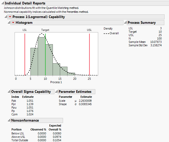

Individual Detail Report for Process 1 shows the Individual Detail Report for Process 1 from the Process Measurements.jmp sample data table as described in Example of the Process Capability Platform with Nonnormal Variables.
The report also shows a Parameter Estimates report if you selected a nonnormal parametric distribution or a Nonparametric Density report if you selected a Nonparametric fit. See Parameter Estimates and Nonparametric Density.

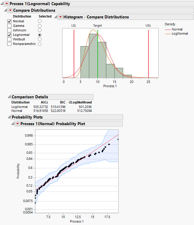

Compare Distributions with Probability Plot for Normal shows the Compare Distributions report for Process 1 in the Process Measurements.jmp sample data table. The Selected distribution, which is Lognormal, is being compared to a Normal distribution. The Comparison Details report shows fit statistics for both distributions.
You can obtain probability plots by selecting the Probability Plots option from the Compare Distributions red triangle menu. The points in the probability plot for the normal distribution in Compare Distributions with Probability Plot for Normal do not follow the line closely. This indicates a poor fit.

Shows or hides a report that displays probability plots for each parametric distribution that you fit. See Compare Distributions with Probability Plot for Normal. An observation’s horizontal coordinate is its mid-point adjusted Kaplan-Meier estimate. An observation’s vertical coordinate is the value of the quantile of the fitted distribution for the observation’s rank. For the normal distribution, the overall estimate of sigma is used in determining the fitted distribution.
