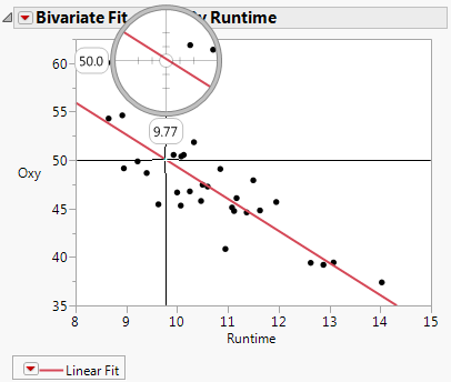

In this example, you fit a regression model that predicts oxygen uptake from Runtime. Then you estimate the Runtime values that result in specified oxygen uptake values. There is only a single X, Runtime, so you start by using the Fit Y by X platform to obtain a visual approximation of the inverse prediction values.
Select Analyze > Fit Y by X.
5.
Click OK.
6.
From the red triangle menu, select Fit Line.
Use the crosshair tool as described below to approximate the Runtime value that results in a mean Oxy value of 50.
7.
Select Tools > Crosshairs.
8.
Click the Oxy axis at about 50 and then drag the cursor so that the crosshairs intersect with the prediction line.
Bivariate Fit for Fitness.jmp shows that a Runtime of about 9.77 gives an inverse prediction of about 50 for Oxy.

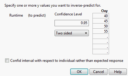

To obtain an exact prediction for Runtime, along with a confidence interval, use the Fit Model launch window as follows:
Click Run.
5.
From the red triangle menu next to Response Oxy, select Estimates > Inverse Prediction.
6.
7.
Click OK.

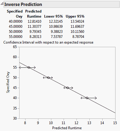

The Inverse Prediction report (Inverse Prediction Report) gives predicted Runtime values that correspond to each specified Oxy value. The report also shows upper and lower 95% confidence limits for these Runtime values, relative to obtaining the mean response.
The exact predicted Runtime resulting in an Oxy value of 50 is 9.7935. This value is close to the approximate Runtime value of 9.77 found in the Bivariate Fit report shown in Bivariate Fit for Fitness.jmp. The Inverse Prediction report also gives a plot showing the linear relationship between Oxy and Runtime and the confidence intervals.

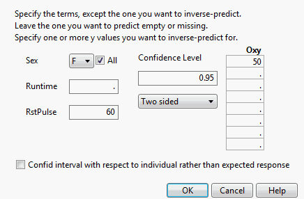

This example predicts the Runtime that results in oxygen uptake of 50 when RstPulse is 60. The Runtime is predicted for both males and females.
Click Run.
5.
6.
Delete the value for Runtime, because you want to predict that value.
7.
8.
Replace the mean for RstPulse with 60.
9.
10.
Click OK.

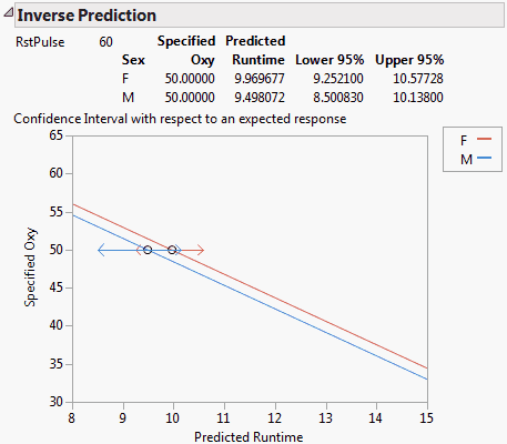

The report, shown in Inverse Prediction Report for a Multiple Regression Model, gives the predicted values of Runtime for both females and males. The report also includes 95% confidence intervals for Runtime values that give a mean response of 50.
The plot shows the linear fits for females and males, given that RstPulse is 60. The two confidence intervals are shown in red and blue, respectively. Note that the intervals overlap, indicating that the true values of Runtime leading to an Oxy value of 50 might be identical for both males and females.
