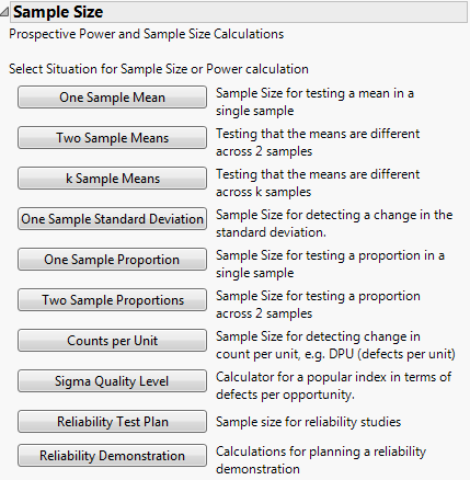

The Sample Size and Power platform helps you plan your study for a single mean or proportion comparison, a two sample mean or proportion comparison, a one-sample standard deviation comparison, a k sample means comparison, or a counts per unit comparison.
Tip: Formulas for the calculations of many of the sample sizes can be found at http://www.jmp.com/en_us/whitepapers/jmp/power-sample-calculations.html.
When you select DOE > Design Diagnostics > Sample Size and Power, the panel in Sample Size and Power Choices appears with button selections for experimental situations. The following sections describe each of these selections and explain how to enter the quantities and obtain the desired computation.
