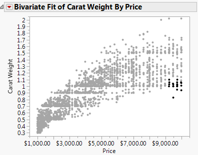

You can locate the next selected row after the current row and cause it to flash by selecting Rows > Next Selected. In a script, you can locate the previously selected text before the currently selected text and by selecting Rows > Previous Selected.
Each time you select Rows > Next Selected, the next selected row is found and flashes. A beep signals when the last selected row is located.
Select Analyze > Fit Y by X.
5.
Click OK.
6.
Select Tools > Lasso.
7.
8.
In the data table, select Rows > Next Selected (or you can press the F7 key).
