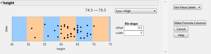

Select Help > Sample Data Library and open Big Class.jmp.
Select the height column.
Select Cols > Utilities > Make Binning Formula.
Change the offset to -0.5.
5.
Keep the width set to 5.
6.
For the labels, keep it set to Use Value Labels, so that you can see the range of values for the bin.
Completed Binning Window
7.
Click Make Formula Columns.
A column called height Binned is added to the Big Class.jmp data table.
8.
