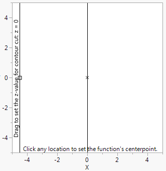

This example uses both Mousetrap() and Handle() to draw a three-dimensional function centered on the Mousetrap() coordinates, where the single contour line takes its value from a Handle().

Mousetrap( // set the origin to the click-point
x0 = x;
y0 = y;
Text(
{-4.25, -4.9},
"Click any location to set the function's centerpoint."
