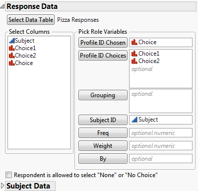

Select Pizza Responses.jmp and click OK.
Select Choice and click Profile ID Chosen.
Select Choice1 and Choice2 and click Profile ID Choices.
Select Subject and select Subject ID.
Response Data Window
Choice1 and Choice2 are the profiles presented to a subject in each of four choice sets. The Choice column contains the chosen preference between Choice1 and Choice2.

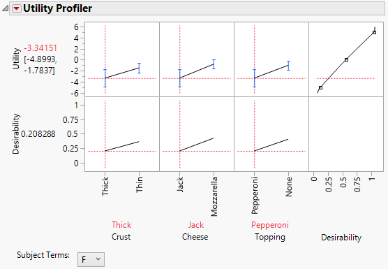

Click the red triangle next to Utility Profiler and select Optimization and Desirability > Desirability Functions.
Utility Profiler with Desirability Function

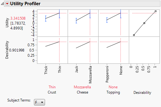

Click the red triangle next to Utility Profiler and select Optimization and Desirability > Maximize Desirability.
Utility Profiler with Optimal Settings for Females
Utility Profiler with Male Level Factor Setting
