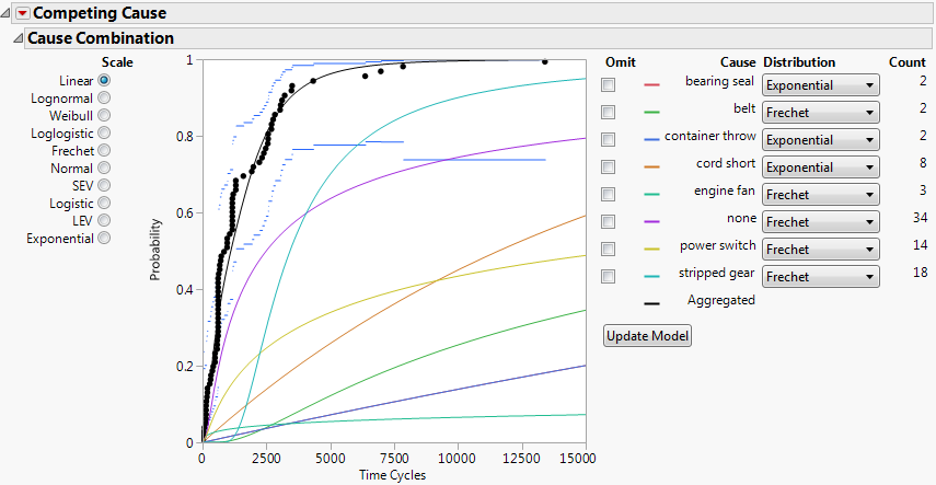

5.
6.
Select Individual Best as the Distribution.
7.
Make sure that AICc is the Comparison Criterion.
8.
Click OK.
10.
Select Omit for bearing seal, belt, container throw, cord short, and engine fan (the causes with the fewest failures).
