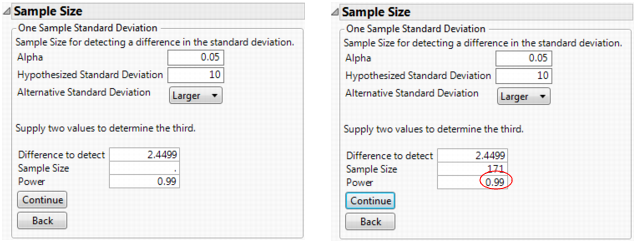

Select DOE > Design Diagnostics > Sample Size and Power.
Click the One Sample Standard Deviation button in the Sample Size and Power Window.
Leave Alpha as 0.05.
Enter 10 for Hypothesized Standard Deviation.
5.
Select Larger for Alternate Standard Deviation.
6.
Enter 2.4499 as Difference to Detect.
7.
Enter 0.99 for Power.
8.
Leave Sample Size blank. (See the left of Window To Compare Single-Direction One-Sample Standard Deviation.)
9.
Click Continue.
The Sample Size is calculated as 171. (See the right of Window To Compare Single-Direction One-Sample Standard Deviation.) This result is the sample size rounded up to the next whole number.
