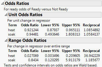

Shows or hides an Odds Ratios report that contains Unit Odds Ratios and Range Odds Ratios, as shown in Odds Ratios.
