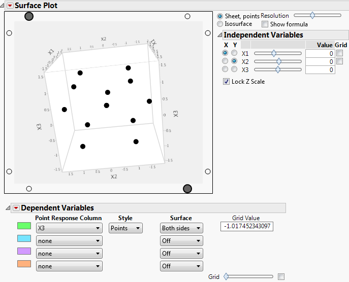

A central composite design (Central Composite Design for Three Factors) combines a two-level fractional factorial design and two other types of points:
Center points, where all the factor values are set to the midrange value.
Axial points, where one factor is set to a high or low value (an axial value) and all other factors are set to the midrange value.
A Box-Behnken design (Box-Behnken Design for Three Factors) has only three levels per factor and has no design points at the vertices of the cube defined by the ranges of the factors. This type of design can be useful when you must avoid these points due to engineering considerations. But, the lack of design points at the vertices of the cube means that a Box-Behnken design has higher prediction variance, and so less precision, near the vertices compared to a central composite design.
