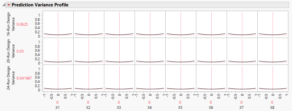

The Prediction Variance Profile plot in Prediction Variance Profile for Three Designs is for the three designs constructed in Designs of Different Run Sizes. Two two-way interactions, X1*X3 and X2*X3, have been added to the Model outline. The initial value for each continuous factor in the plot is the midpoint of its design settings. The Variance values to the left indicate that, as the number of runs increases, the variance decreases at the center point.
For given settings of the factors, the prediction variance is the product of the error variance and a quantity that depends on the design and the factor settings. Before you run your experiment, the error variance is unknown, so the prediction variance is also unknown. However, the ratio of the prediction variance to the error variance is not a function of the error variance. This ratio, called the relative prediction variance, depends only on the design and the factor settings. Consequently, the relative variance of prediction can be calculated before acquiring the data. For details, see Relative Prediction Variance in Technical Details.

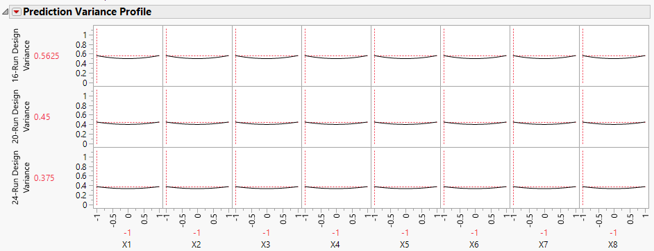

You can also evaluate a design or compare designs in terms of the maximum relative prediction variance. Select the Optimization and Desirability > Maximize Desirability option from the red triangle next to Prediction Variance Profile. JMP uses a desirability function that maximizes the relative prediction variance. The value of the Variance in the Prediction Variance Profile is the worst (least desirable from a design point of view) value of the relative prediction variance.
Prediction Variance Profile Showing Maximum Variance for Three Designs shows the Prediction Variance Profile after Maximize Desirability was selected for the three designs constructed in Designs of Different Run Sizes. As expected, the maximum relative prediction variance decreases as the run size increases. The plot also shows values of the factors that give this worst-case relative variance. However, keep in mind that many settings can lead to this same maximum relative variance.
