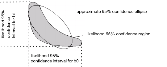

Diagram of Confidence Limits for Parameters shows the contour of the goal SSE or negative likelihood, with the least squares (or least loss) solution inside the shaded region:
