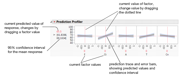

The Profiler (or Prediction Profiler) shows prediction traces for each X variable.
Illustration of Prediction Traces illustrates part of the profiler for the Reactor.jmp sample data table. The vertical dotted line for each X variable shows its current value or current setting. Use the Profiler to change one variable at a time in order to examine the effect on the predicted response.
The factors F and Ct in Illustration of Prediction Traces are continuous. If the factor is nominal, the x-axis displays the levels.
The horizontal dotted line shows the current predicted value of each Y variable for the current values of the X variables.
