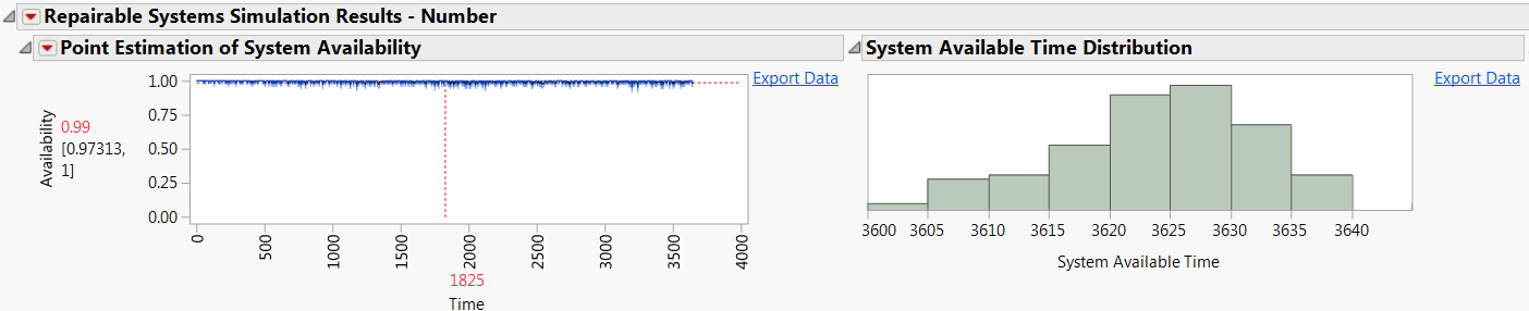

By default, the report contains two types of graphs. The first type of graph, shown on the left side of Partial RSS Explorer Report, is a point estimate graph. The point estimate graph displays aggregated simulation results on the y-axis plotted against simulation iteration time on the x-axis. The range of the x-axis is the duration that you specify in the simulation settings. The estimated probability of the system being available at a given time is shown in red next to the y-axis. Below the point estimate is a 95% confidence interval for the point estimate.
Tip: To see the point estimation of system availability at a specific time in the simulation iteration, click the red number below the x-axis. Specify a time within the range of the simulation duration and press Enter.
The second type of graph, shown on the right side of Partial RSS Explorer Report, is a histogram of the system available time from the simulation iterations. The bins in the histograms are representative of one of the following:
Tip: Select the Export Data option beside a graph to create a data table with the data that the graph uses.
