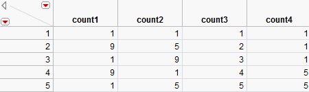

Count (1, 9, 2) gives Count 1
Count (1, 9, 3) gives Count 2
Count (1, 9, 9) gives Count 3
Count (1, 9, 3, 3) gives Count 4
