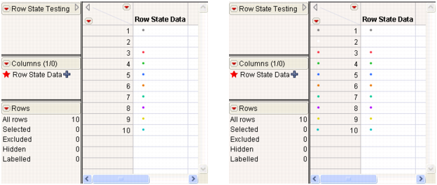

dt = New Table( "Row State Testing" );
dt << New Column( "Row State Data", Row State, Set Formula( Color State( Row() ) ) );
dt << Add Rows( 10 );
For Each Row( Row State() = :Row State Data );
This action replaces any row states in effect with the row state combination from the row state column. For details about how to change selected attributes of a row state without changing or canceling others, see Set One Characteristic and Cancel Others.
