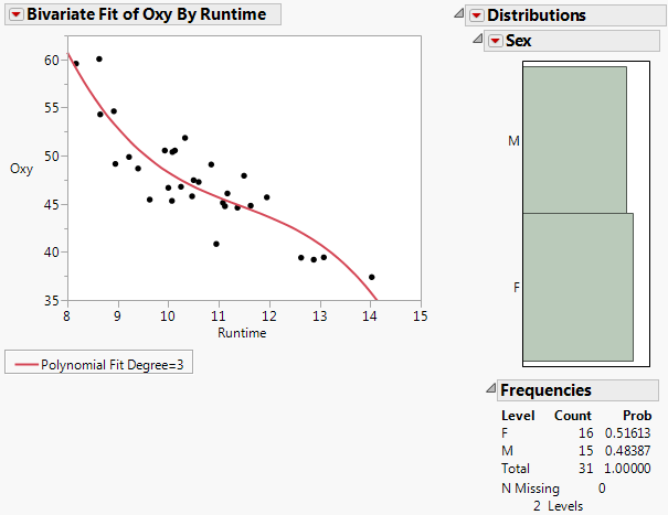

The example in Multiple Analysis Results in a Layout Window shows results combined and organized from a bivariate analysis, distribution analysis, and one-way analysis (means and t test). The result shows a summary of oxygen uptake as a function of run time in an exercise experiment. This was done by forming a layout window for one analysis, dragging the other desired analysis elements into the layout window, arranging the desired pieces, and deleting unwanted elements.
