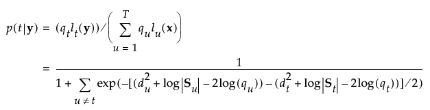

See Notation for Formulas Given by Save Formulas Options for notation. The Mahalanobis distance from an observation y to group t is defined as follows:
The posterior probability of membership in group t is the following:
An observation y is assigned to the group for which its posterior probability is the largest.

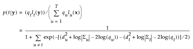

This method enables you to leverage two aspects of regularization to bring stability to estimates for quadratic discriminant analysis. See Friedman, 1989. See Notation for Formulas Given by Save Formulas Options for notation.
The posterior probability of membership in group t given by the following:
