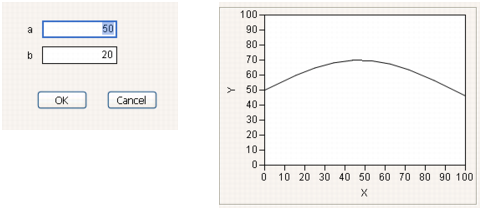

This example uses the Here scope to pass information between windows that are created by the same script. Scoping a variable using Here: is not dependent on turning Names Default To Here() on. The Here: scope is always available.
The Launcher window asks the user for two values. Those two values are passed to the Output window, which uses them to graph a function. The Launcher window scopes aBox and bBox to the window: essentially, those two variables (pointers to Number Edit Boxes) exist only in the Launcher window and are not available to the Output window. The values from those two boxes are then copied into variables that are scoped to Here, and so are available to both windows that are produced by this script.
launchWin = New Window( "Launcher",
<<Modal,
V List Box(
Lineup Box( N Col( 2 ), Spacing( 10 ),
Text Box( "a" ),
window:aBox = Number Edit Box( 50 ),
Text Box( "b" ),
window:bBox = Number Edit Box( 20 ),
Lineup Box( N Col( 2 ), Spacing( 20 ),
Button Box( "OK",
// copy values before window goes away
here:a = window:aBox << Get;
here:b = window:bBox << Get;
Button Box( "Cancel", Throw( 1 ) )
New Window( "Output",
Graph Box( Y Function( here:a + here:b * Sin( x / 30 ), x ) )
