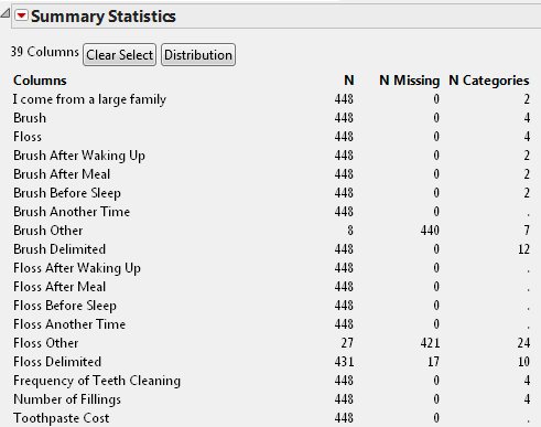

The Columns Viewer gives you a quick view of data table characteristics. For example, the Summary Statistics report shows which columns contain missing values (Identify Missing Values). You can select those columns in the report and then exclude them in the data table.
the number of rows with missing values (N Missing)
the number of categories (N Categories)
Creates a linked Summary Statistics report for the selected columns. Right-click to select options such as sorting by column or creating a data table. Select Show Quartiles to include lower quartiles, upper quartiles, and interquartile ranges. And to create a linked data table from all columns in the report, select Data Table View from the Summary Statistics red triangle menu.

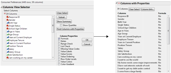

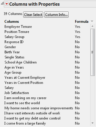

Shows a list of column properties in the Columns with Properties report. Select the properties that you want to find and then click OK to create a linked report from all columns. Or you can select columns first in the Select Columns list and then show the list of properties just for those columns.

The Columns with Properties report appears. Several columns include the Formula property (Select the Formula Column Property). Because the list is so long, you want to view all formula columns together.

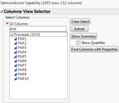

Select Cols > Columns Viewer to open the Data Table Columns Viewer window.
In the Select Columns red triangle menu, select Name Starts With.

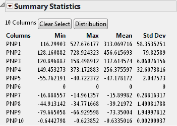

5.
6.

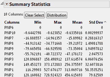

Right-click in the report and select Sort by Column.
7.
Notice that PNP6 has no standard deviation, because the minimum, maximum, and mean values are 0.

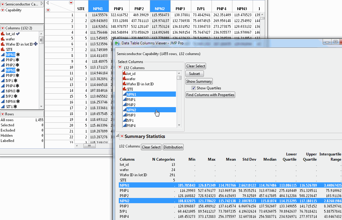

In the Summary Statistics report, select the row for PNP6 and then display the data table.
9.
View the data table and press Delete to remove the selected column.
