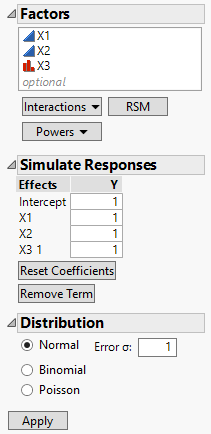

Simulate Responses Control Window shows the Model window for a design with two continuous factors (X1 and X2) and one two-level categorical factor (X3).
