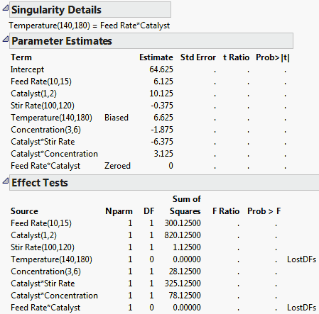

is singular, and the Fit Least Squares report displays a report entitled Singularity Details immediately below the main title bar (Singularity and Parameter Estimates Report for Model with Linear Dependencies). This report gives expressions that describe the linear dependencies. The terms involved in these linear dependencies are aliased (confounded).
is singular, and the Fit Least Squares report displays a report entitled Singularity Details immediately below the main title bar (Singularity and Parameter Estimates Report for Model with Linear Dependencies). This report gives expressions that describe the linear dependencies. The terms involved in these linear dependencies are aliased (confounded).Singularity and Parameter Estimates Report for Model with Linear Dependencies shows reports for the Reactor 8 Runs.jmp sample data table. To obtain these reports, fit a model with Percent Reacted as Y. Enter Feed Rate, Catalyst, Stir Rate, Temperature, Concentration, Catalyst*Stir Rate, Catalyst*Concentration, and Feed Rate*Catalyst as model effects.
