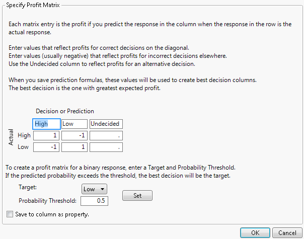

You can assign profit and cost values to each combination of actual and predicted response categories. To specify the costs of classifying into an alternative category, enter values in the Undecided column. To save your assignments to the response column as a property, check Save to column as property. Leaving this option unchecked applies the Profit Matrix only to the current Partition report.
When the response is binary, instead of entering weights into the profit matrix, you can specify a probability threshold in the Profit Matrix window. For details about how values are calculated for the profit matrix, see Profit Matrix in the Using JMP book.
When you define costs using the Specify Profit Matrix option and then select Show Fit Details, a Decision Matrix report appears. See Decision Matrix Report.
