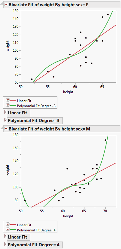

The following example uses the Big Class.jmp data table, which contains the names, ages, sex, heights, and weights for 40 students. Create a bivariate report of weight by height, using sex as a By variable, and adding a variety of fits.
biv = dt << Bivariate( Y( weight ), X( height ), By( sex ));

In the log, rather than returning a single reference to a platform, Bivariate[], the platform object returns a list of references: biv = {Bivariate[], Bivariate[]}. The two references correspond to the two levels (F and M) of the By variable, sex.
biv << Fit Line;
5.
biv[1] << Fit Polynomial( 3 );
7.
8.
biv[2] << Fit Polynomial( 4 );
9.
