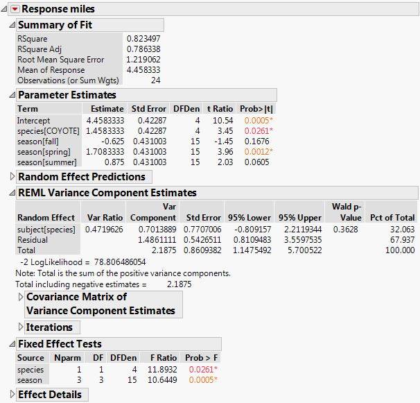

Consider the data in the Animals.jmp sample data table (the data are fictional). The study collected information about differences in the seasonal hunting habits of foxes and coyotes. Each season for one year, three foxes and three coyotes were marked and observed periodically. The average number of miles that they wandered from their dens during different seasons of the year was recorded (rounded to the nearest mile). The model is defined by the following aspects:
An animal identification code called subject, with nominal values 1, 2, and 3 for both foxes and coyotes
The top layer is the between-subject layer, in which the effect of being a fox or coyote (species effect) is tested with respect to the variation from subject to subject.
The bottom layer is the within-subject layer, in which the repeated-measures factor for the four seasons (season effect) is tested with respect to the variation from season to season within a subject. The within-subject variability is reflected in the residual error.
The season effect can use the residual error for the denominator of its F-statistics. However, the between-subject variability is not measured by residual error and must be captured with the subject within species (subject[species]) effect in the model. The F-statistic for the between-subject effect species uses this nested effect instead of residual error for its F-ratio denominator.

When you define an effect as random using the Attributes menu, the Method options (REML and EMS) appear at the top right of the dialog, with REML selected as the default. The populated launch window is shown in Fit Model Dialog.
11.
Click Run.
The report is shown in Partial Report of REML Analysis. Both fixed effects, species and season, are significant. The REML Variance Component Estimates report gives estimates of the subject within species and residual variances.
