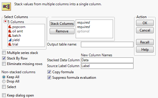

You can rearrange your data table by stacking two or more columns into a single new column, preserving the values from the other columns. Or, you can stack a set of columns into multiple groups. The various ways that you can stack columns are explained in Stack Options.
Select Tables > Stack.
Click OK.
Select the Contiguous option if the series consists of adjacent columns.
Eliminates missing data from the new table. If Stack by Rows is checked also, only rows with all data missing are eliminated.
Assigns a name to the column that will contain the data for the stacked columns. The default name is Data. Leave the box empty if you do not want this column to appear in the new table.
Assigns a name to the column that will contain the original table’s column names. The default name is Label. Leave the box empty if you do not want this column to appear in the new table.
