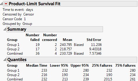

For data that is not interval censored, the initial reports show Summary and Quantiles data (Summary Statistics for the Univariate Survival Analysis). The Summary data shows the number of failed and number of censored observations for each group (when there are groups) and for the whole study. The mean and standard deviations are also adjusted for censoring. For computational details about these statistics, see the SAS/STAT User’s Guide (2001).

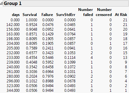

Example of Survival Estimates Table shows an example of the product-limit survival function estimates for one group.
Note: When the final time recorded is a censored observation, the report indicates a biased mean estimate. The biased mean estimate is a lower bound for the true mean.
