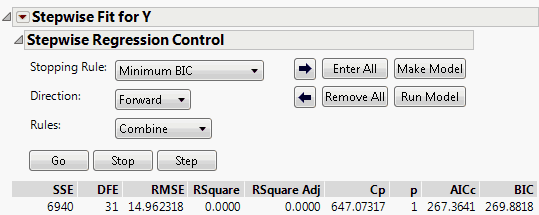

Notice that the default selection for Direction is Forward.

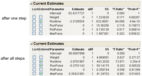

Click Step.
From the top figure in Current Estimates Table for Forward Selection, you can see that after one step, the most significant term, Runtime, is entered into the model.
Click Go.
The bottom figure in Current Estimates Table for Forward Selection shows that all of the terms have been added, except RstPulse and Weight.

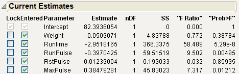

Click Enter All.
For Direction, select Backward.

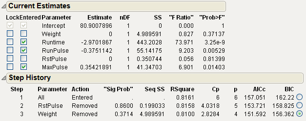

Click Step two times.
The Current Estimates and Step History tables shown in Current Estimates with Terms Removed and Step History Table summarize the backward stepwise selection process. Note the BIC value of 156.362 for the third step in the Step History table. If you click Step again to remove another parameter from the model, the BIC value increases to 159.984. For this reason, you choose the step 3 model. This is also the model that the Go button produces.
