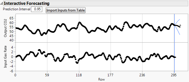

Each transfer function model is added to the Model Comparison table. If the Report checkbox for a transfer function model in the Model Comparison table is selected, a Transfer Function Model report is produced. Each Transfer Function Model report contains the following reports:
The information in the Model Summary, Parameter Estimates, Residuals, and Iteration History reports is the same as in the Time Series report. For more information about these reports, see Model Report. The Parameter Estimates table is followed by the formula of the model, where B is the backshift operator.
