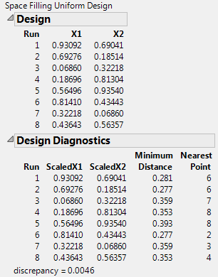

Click the Uniform button. JMP creates this design and displays the design runs and the design diagnostics as shown in Factor Settings and Diagnostics for Uniform Space-Filling Designs with Eight Runs.
Note: The emphasis of the Uniform design method is not to spread out the points. The minimum distances in Factor Settings and Diagnostics for Uniform Space-Filling Designs with Eight Runs vary substantially.

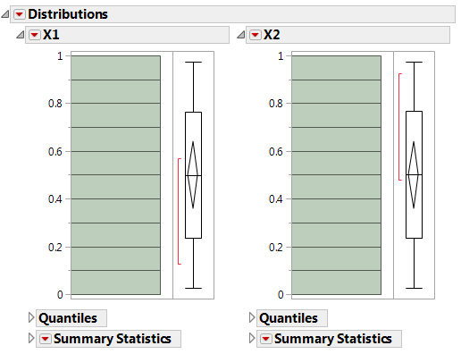

A Uniform design does not guarantee even spacing of the factor levels. However, increasing the number of runs and running a distribution on each factor (use Analyze > Distribution) shows flat histograms.
